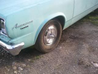

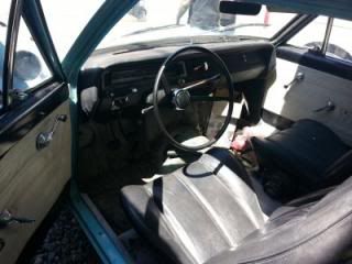

These pics are from the day I bought the car.
Nice uncut dash
Inside

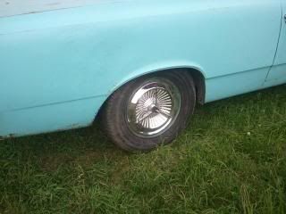

I scored the original hub caps back.

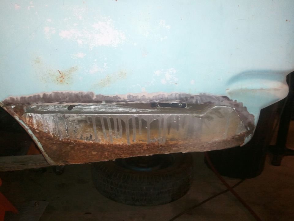

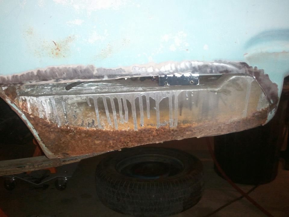

and here is the worst of the rust in the whole car. I will be making a new custom patch piece by hand for this.

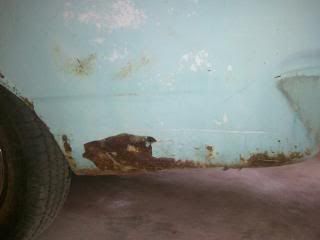

Now moving back to the drivers rear 1/4 panel with all the rust. I had to cut out all the old and prep it for the new handmade custom patch panel.
Here is what I am starting with.
And after I got it all cut out.

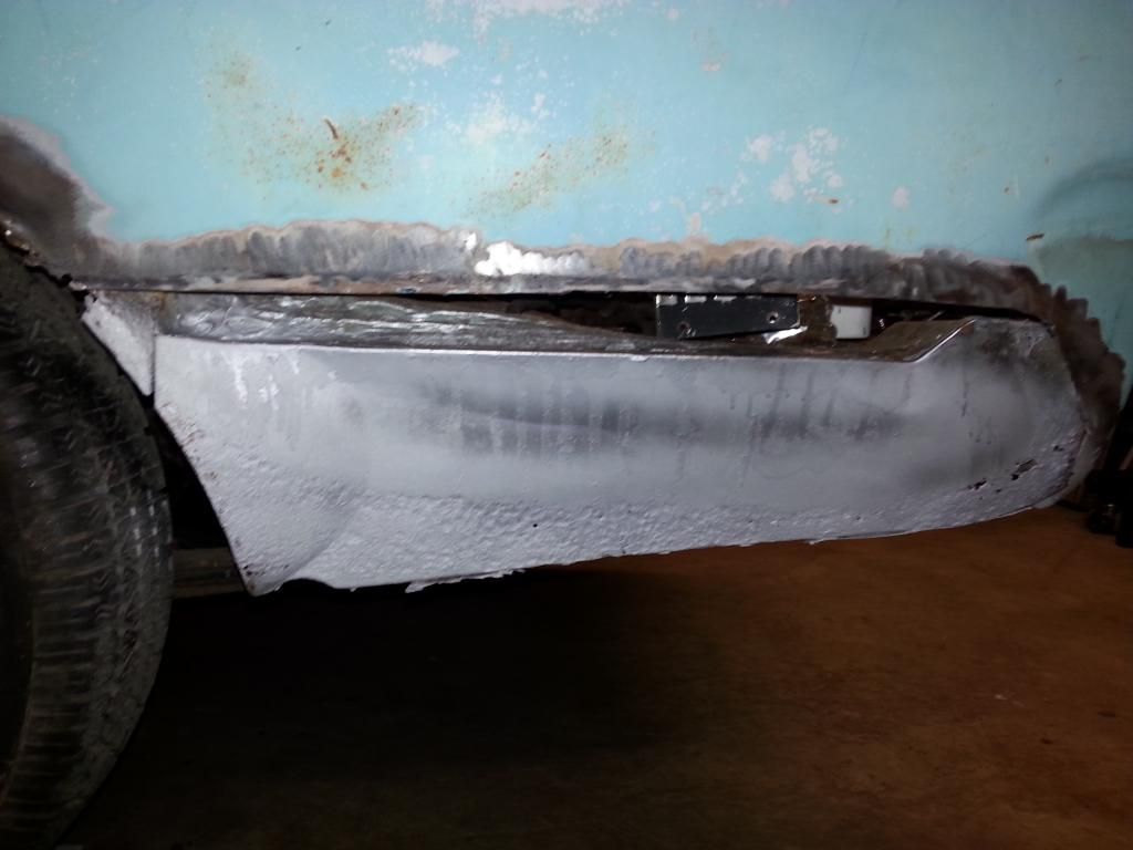

Post by RewT » 23 May 2014, 06:20

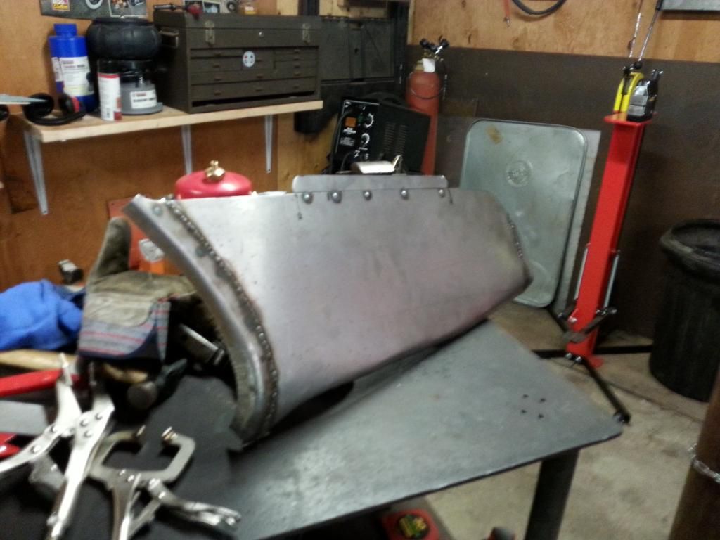

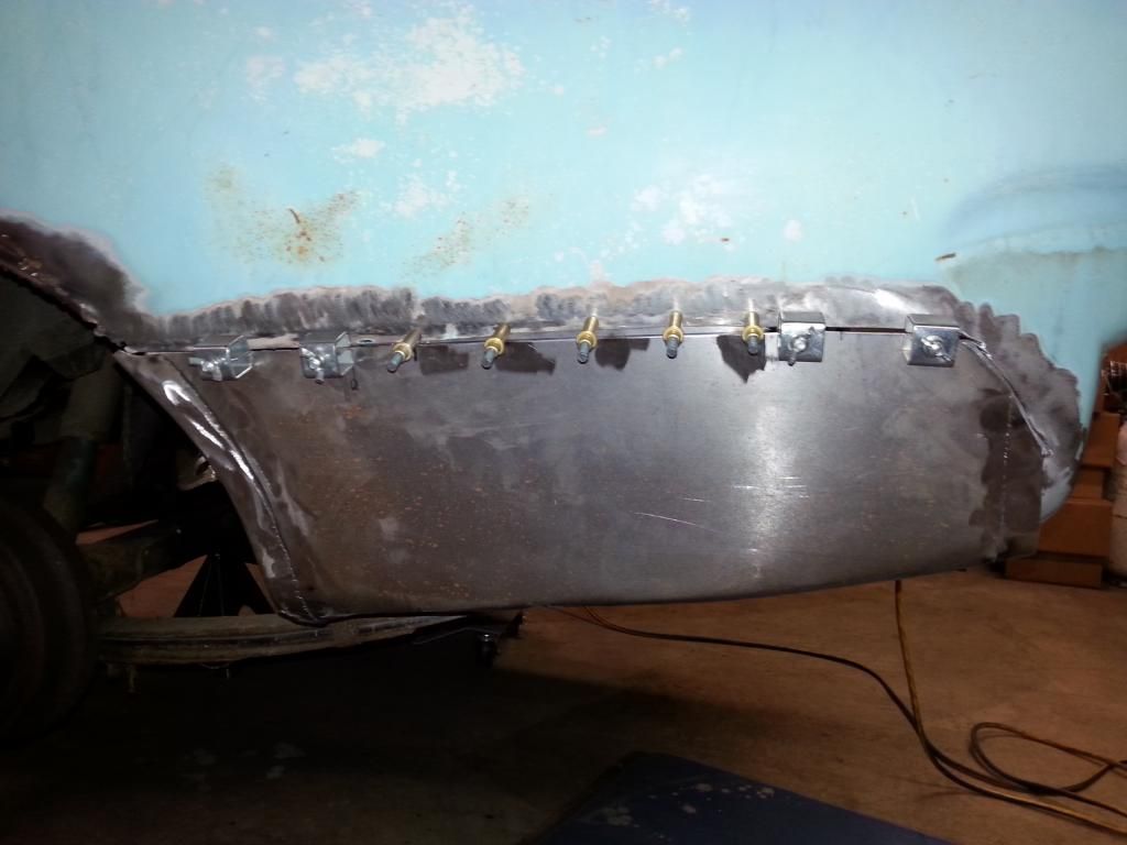

Prepped and primered almost ready for the outer skin.

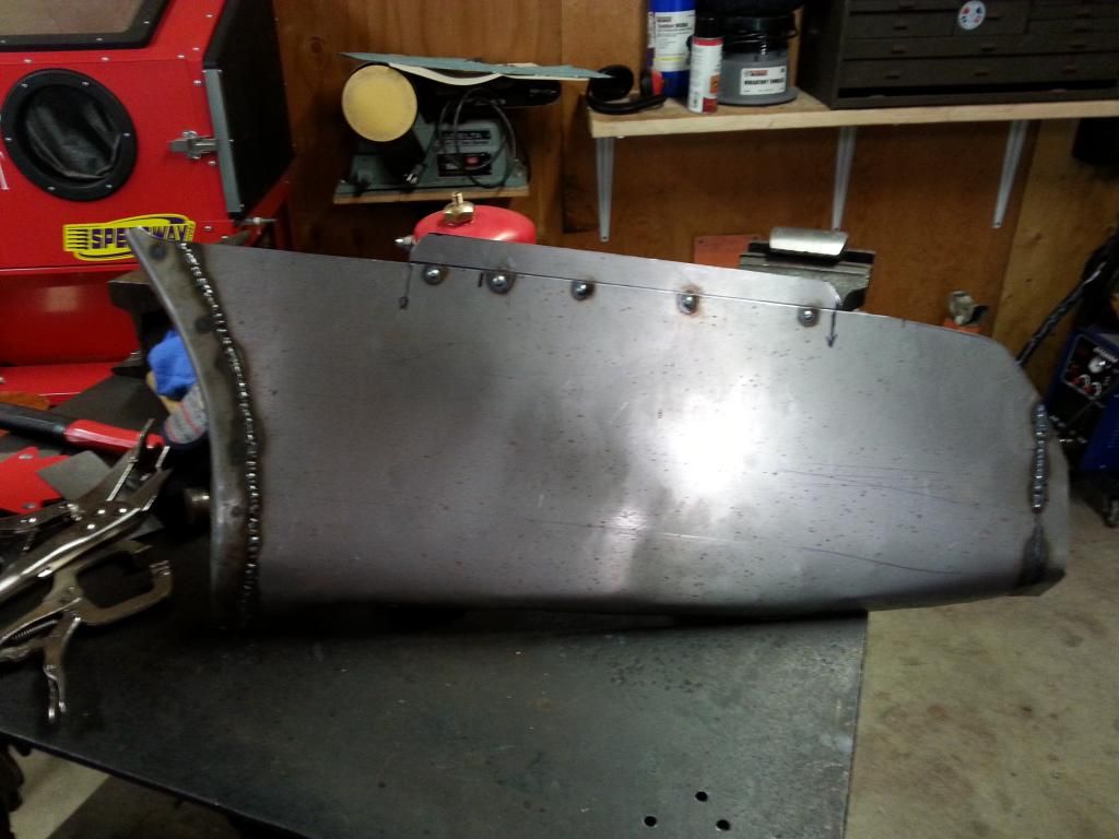

Handmade by me 3 piece patch panel.

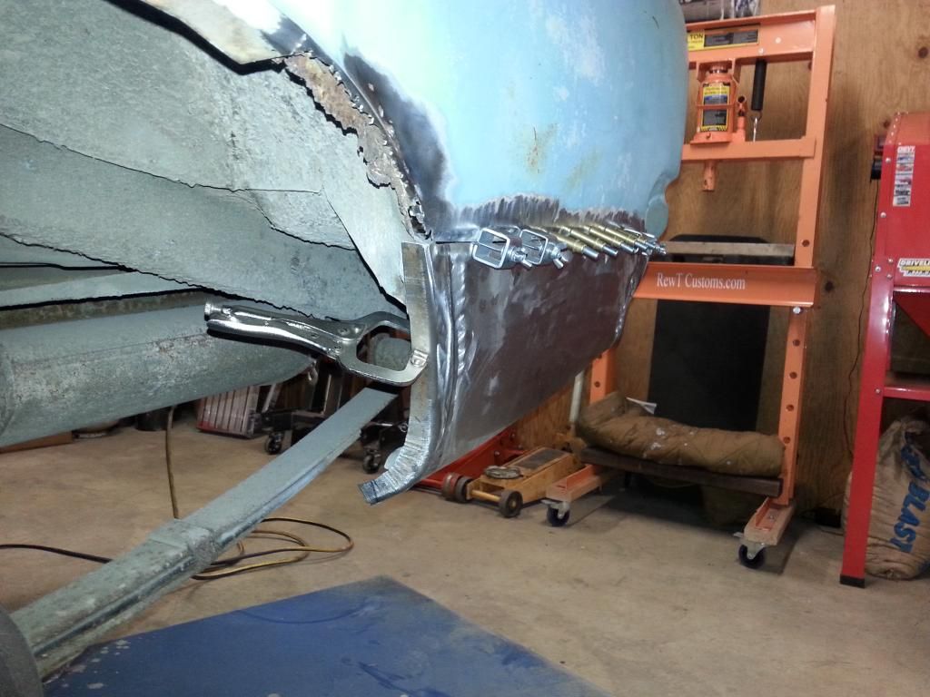

Getting it all lined up ready for welding.
tacking it into place.
Now I just need to replace the rest of the wheel well and then grind, sand and prep for paint.

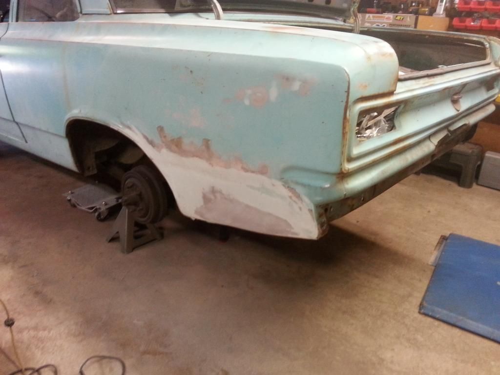

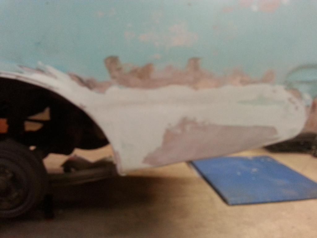

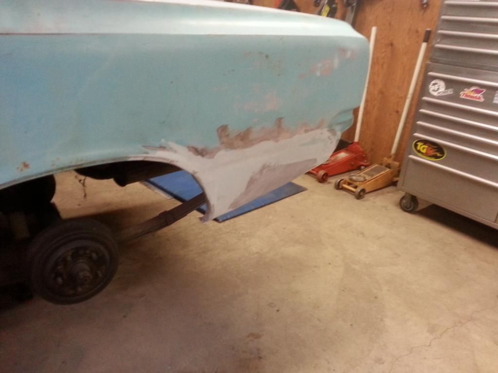

More stuff done. finished welded the patch panel and ground it down smooth. then some body filler was use to make it all go away.

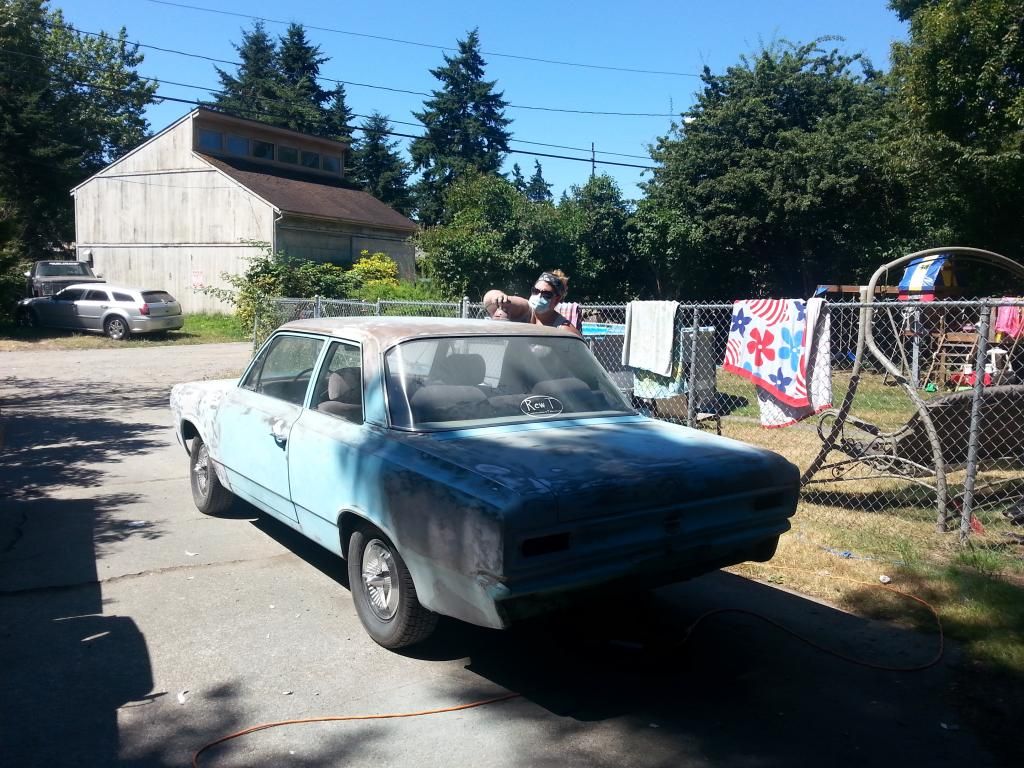

Post by RewT » 16 Jul 2014, 20:11

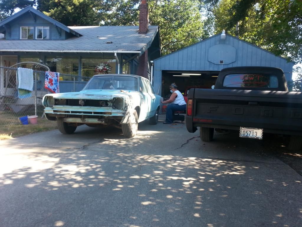

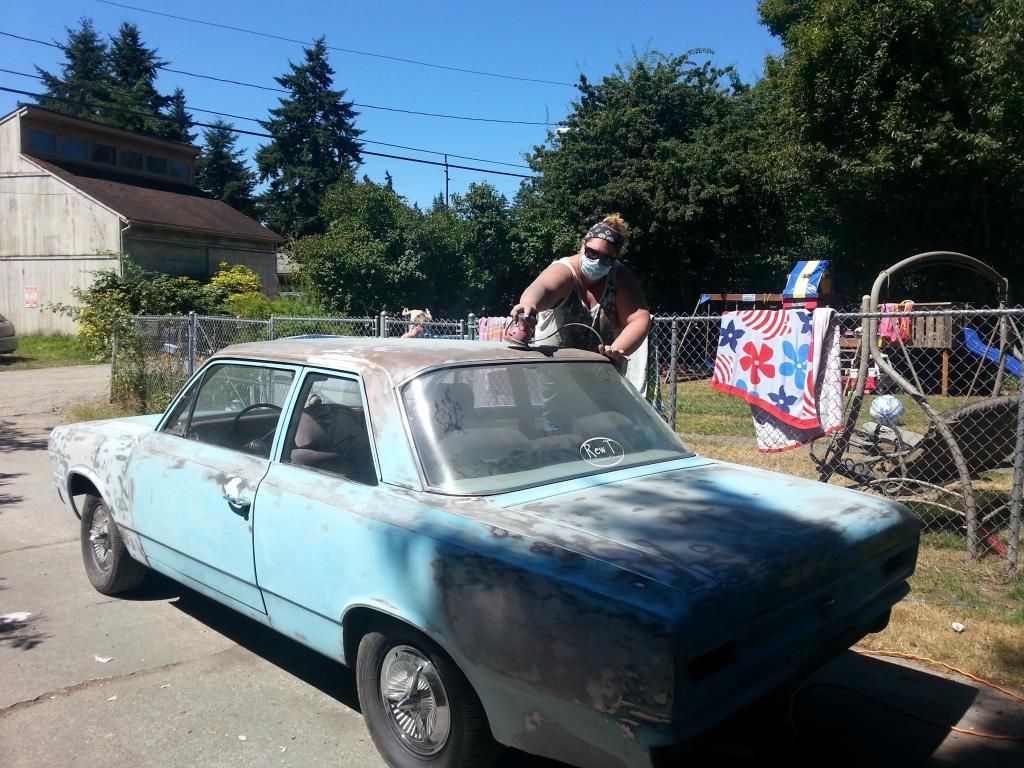

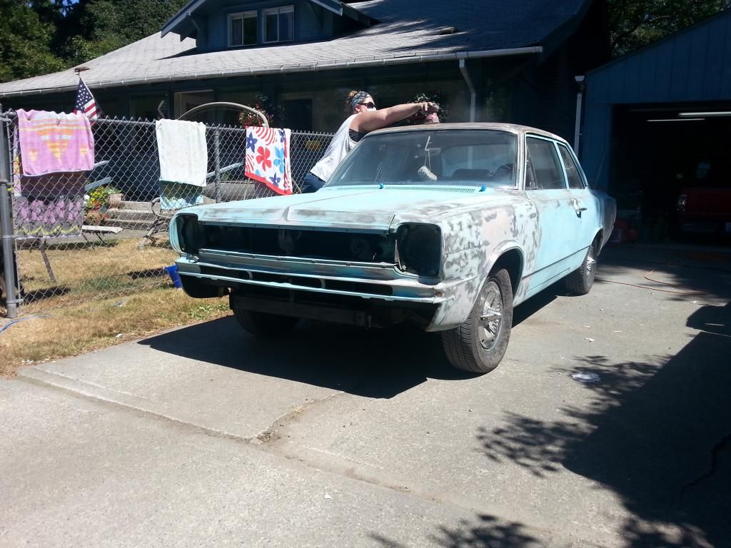

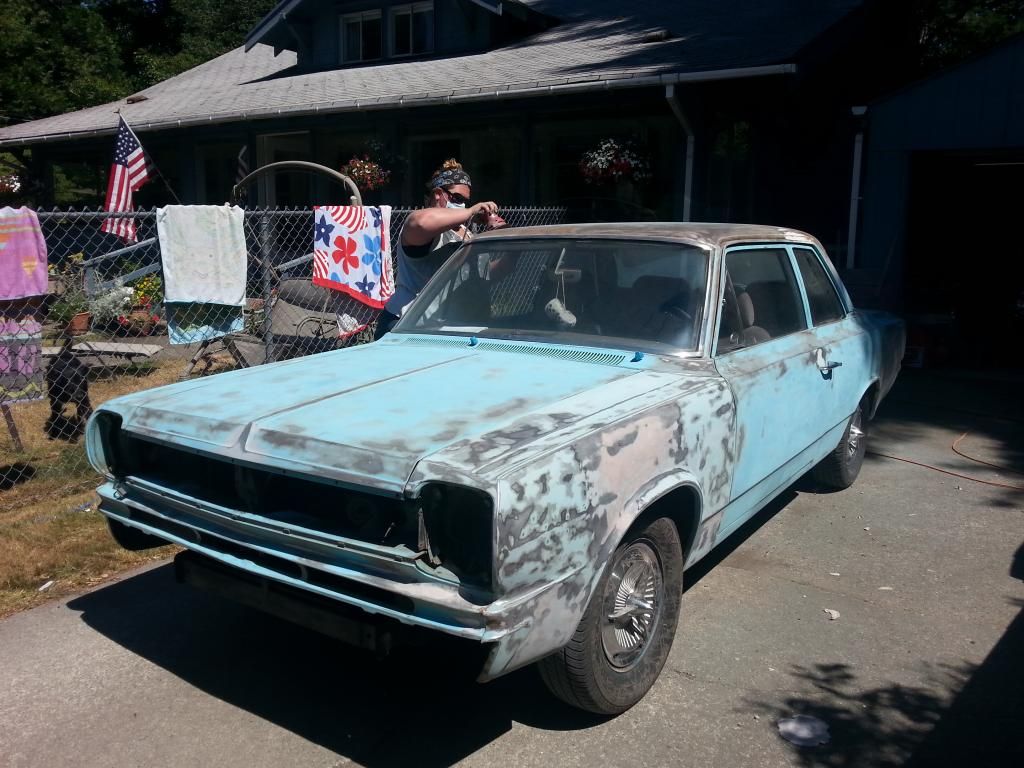

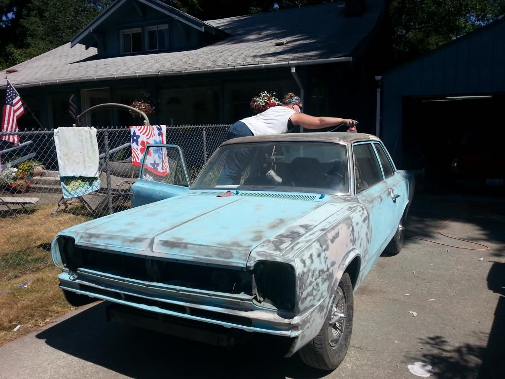

With the heat the last couple of weeks its been hard working in the shop. So the other day My wife Jessica had some time off and wanted to help work on the Rambler. So I handed her the sander and paper and she went to town..
