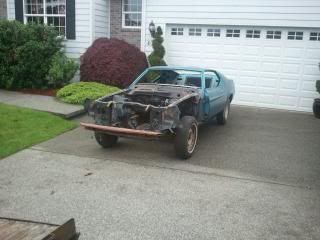

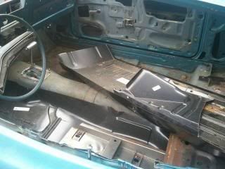

And here are some pics.
The day we picked it up.

Replacement floors.

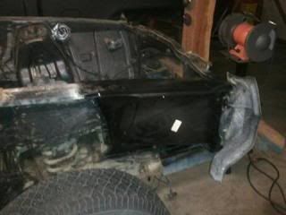

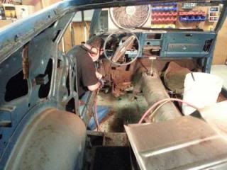

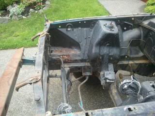

These first group of pics are the removal and redo of the passanger fender apron.
Using the spot welder cutter.
Removing the old piece by piece.
And all removed ready for grinding.
This is the lower battery reinforcement. Didn't come with the replacement panel and nobody is remaking them. So broke out some tools and made my own.
Laying out the lines for the beads I will roll into it.
_________________
Top
 Profile
PostPosted: 01 Jul 2013, 06:03
Offline
Posts: 958

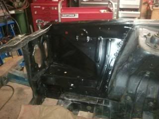

And here are the after shoots of the front apron repair.

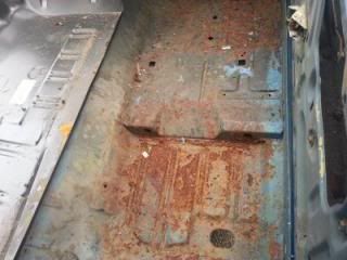

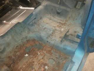

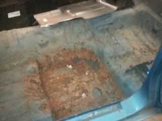

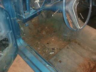

And now onto the rusty floor repair. I did one side at a time, starting with the front section and then the rear. This is a 6 piece floor repair.
Some before pics of the rusty floors.
And the removal of the old floor.

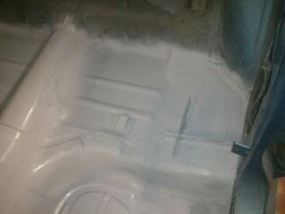

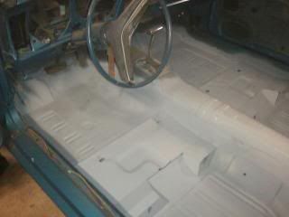

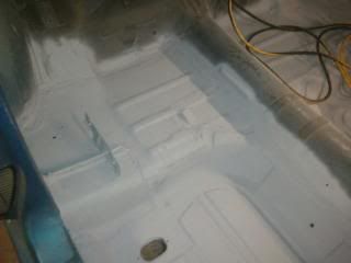

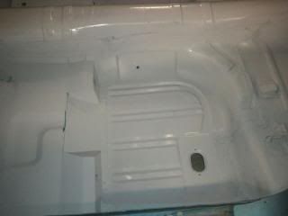

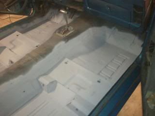

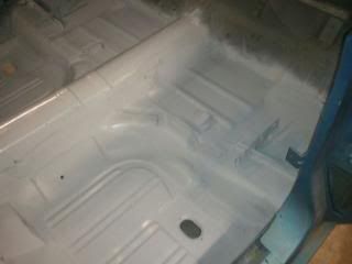

And here are the finished product shots. all the under metal was coated in a POR15 style paint.Then the floor was prepped with weld through primer then a fill primer. All the underside brackets had to be drilled and cut off, and then cleaned and re-welded to the new floor pan. Then the underside was undercoated.
And the pics of the finished product.
