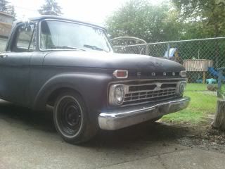

Here are a couple of pics after the new Satin black paint.

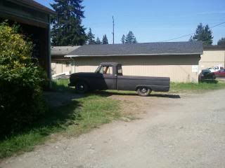

Got the Front droped today.
Still got to do the SUA swap to get the rear down where i want it.
Now i got to get the rear down about 2 more inchs. This is as low as this trucks going, until next year when it going to get full airide.

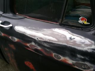

decided Im not going to put the door badge back on, so i broke out the welder and filler and got some work done.
sanded down, ready for welding
all welded up, now just needs grinding
what holes????
