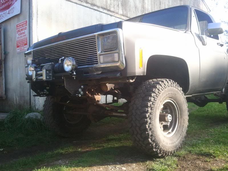

This last week I sold the old rims and tires and the bed, So I got some cash for some more upgrades. I am going to start with some lighting. Front and rear and some tow hooks on the front too. Had alittle time this afternoon so I got to work. Here are some pics.
This is what I got.
Round lights on the front, and the square ones on the rear of the cab.
Then I installed the front light and tow hooks.
And the front end done for now..

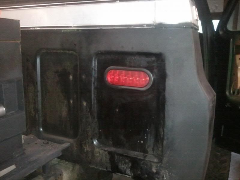

Tailight install.. I wanted some kind of brake light in the rear, I don't want to get rear ended on the trail ever again. I debated where to mount these, finally decided on the back of the cab. Had some spare time this afternoon, so I got it done..
Laying out the cut line.
Drilling out the holes with a holesaw.
And installed.

And finished them up today.
This is just the taillights, not the brake, yep it gets brighter....

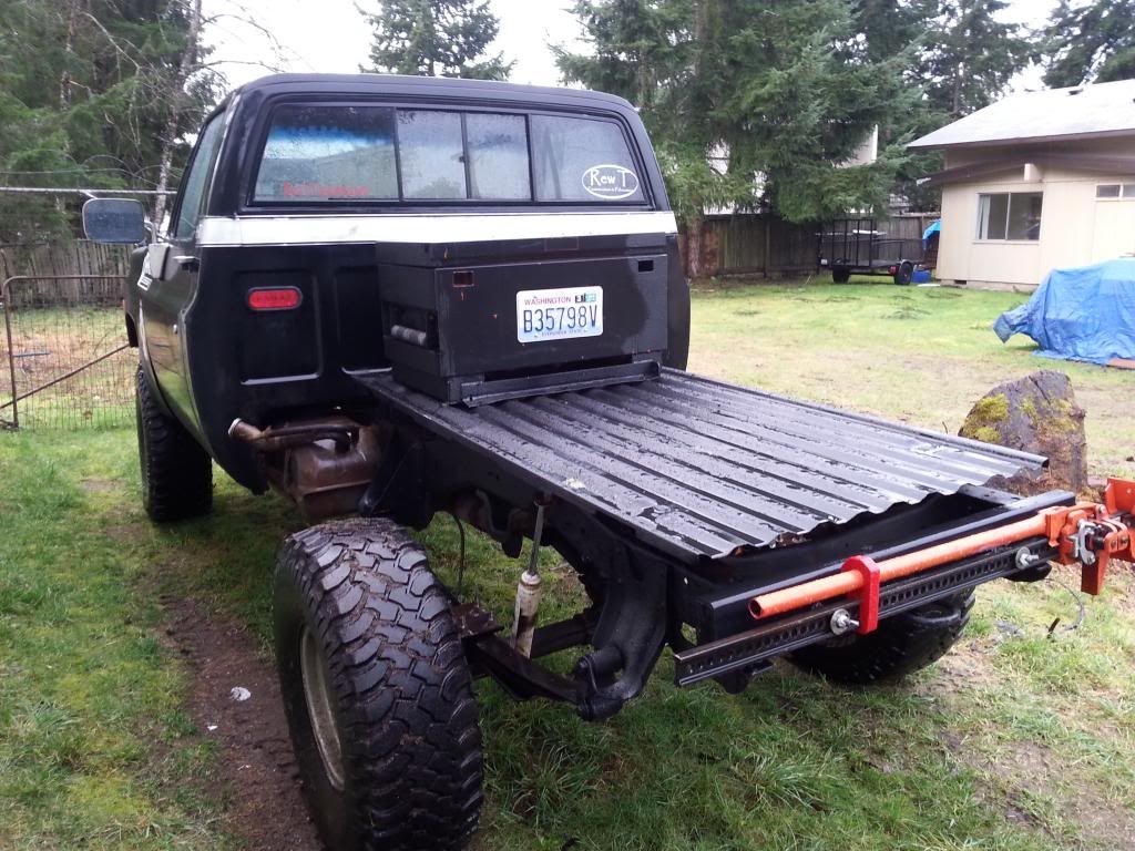

Then it was time to do the rear. The gear oil in the rear axle was in pretty sad shape and needed to be changed. Here are some of the pics.
Sandblasted and ready for welding..
Same plate I used on the front diff. but this one covers all the ring part.
Here is the after with the little side piece I added for extra protection, and I finally painted the flat bed..

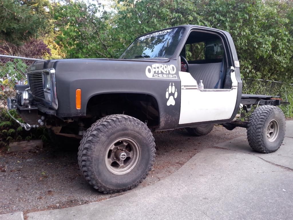

Alright, the next thing on the long list of stuff I want to get done is making it easier to see out of this big cab. When I had Ugly I made a big hole in the fire wall and put plexi glass over it and could see right down onto the tire, this worked great..
After getting some seat time in this rig I came to the conclusion I need to see out of it better.. So I started making some half doors that I scored of the C-10 board for $40. Didn't take very long to do and makes a lot of difference, Now to finish bracing and plating the top also go to make some custom door cup holders. This is what I got done so far.
Laying out the cut lines, next step was gutting the inside and removing all the glass.
The next 3 are of the doors before trimming them down.
And what its like now. trimmed the front and rear down, Door button still works and so does the lock..
